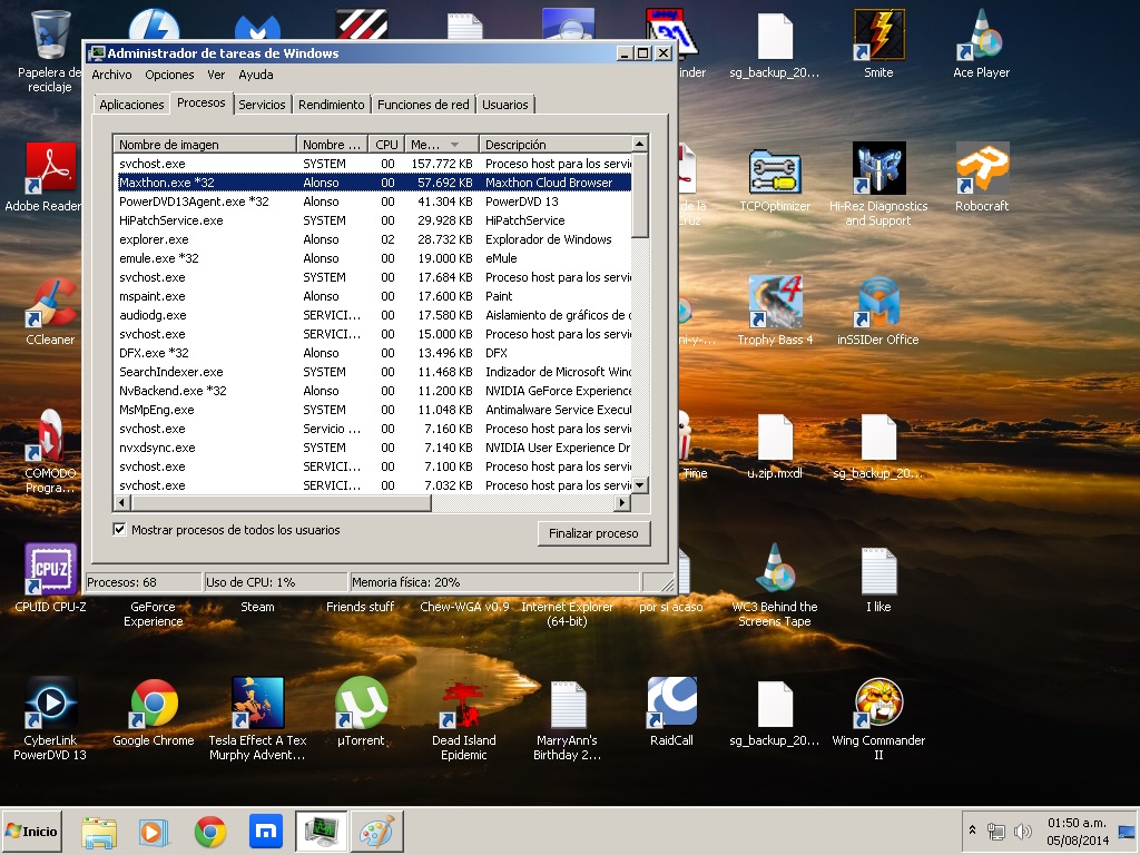

Alojavi23 Posted August 5, 2014 Report Share Posted August 5, 2014 I don't know if this is happening to everybody with last updates but when i'm using Maxthon for a while watching videos, i notice that its process doesn't close after closing the browser. Tip Give Link to comment Share on other sites More sharing options...
BugSir007 Posted August 5, 2014 Report Share Posted August 5, 2014 Hi Alojavi23, Really sorry for the inconvenience brought to you. Normally there shouldn't be processes still running after closing the browser.:L Does the problem occur to every video you watch? Any links to test? If convenient, we would like you to provide a screen shot to see which process is running. Maybe it's a sync related process... Looking forward to hearing from you. Thanks for your support. Tip Give Link to comment Share on other sites More sharing options...
Alojavi23 Posted August 5, 2014 Author Report Share Posted August 5, 2014 Here is the pic, no maxthon running and process keep running. Tip Give Link to comment Share on other sites More sharing options...
joemax Posted August 5, 2014 Report Share Posted August 5, 2014 Alojavi23 replied at 2014-8-4 22:23 Here is the pic, no maxthon running and process keep running. End the task and reboot, it does happen but not very often. Tip Give Link to comment Share on other sites More sharing options...
BugSir007 Posted August 5, 2014 Report Share Posted August 5, 2014 I just experienced the same issue here and i couldn't open extensions manager page. You can manually kill that process and reboot the browser. It works fine now. Tip Give Link to comment Share on other sites More sharing options...

jbriggs Posted September 9, 2014 Report Share Posted September 9, 2014 BugSir007 replied at 2014-8-5 00:55 I just experienced the same issue here and i couldn't open extensions manager page. You can manually ... I have the same issue. I'll exit maxthon and many processes will continue to run. They seem to be active as there's alot of bytes being read and/or written in memory and IO. Tip Give Link to comment Share on other sites More sharing options...
magg Posted September 9, 2014 Report Share Posted September 9, 2014 jbriggs replied at 2014-9-9 10:11 I have the same issue. I'll exit maxthon and many processes will continue to run. They seem to be ... Try to uncheck "Minimize to system tray" and "Close to system tray" in Maxthon settings under Advanced Tab. Tip Give Link to comment Share on other sites More sharing options...
jbriggs Posted October 2, 2014 Report Share Posted October 2, 2014 magg replied at 2014-9-9 11:28 Try to uncheck "Minimize to system tray" and "Close to system tray" in Maxthon settings under Adv ... "Close to system tray" Not Checked. That'll obviously cause this issue. "Minimize to system tray" I did have checked. Unchecking it fixed the problem. Tip Give Link to comment Share on other sites More sharing options...
