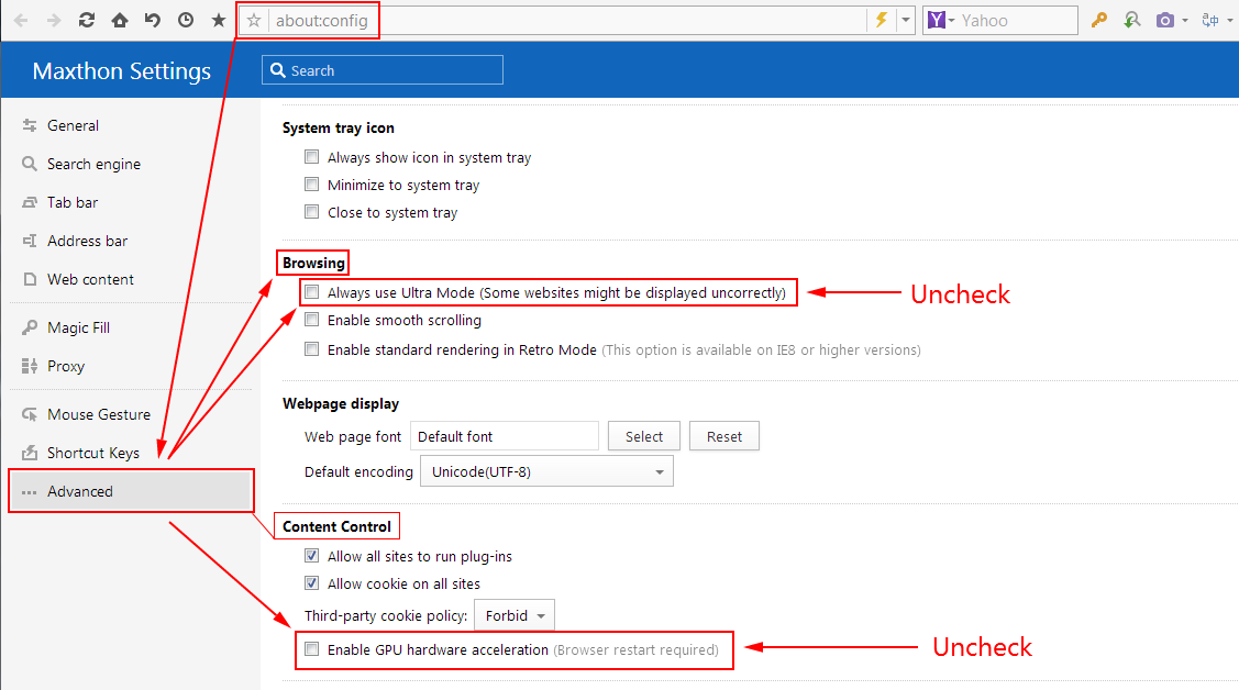

Positronis Posted July 7, 2014 Report Share Posted July 7, 2014 1402170908 replied at 2014-7-6 14:59 Positronis-I have upgraded my Maxthon Could it works better the 4.4.2.600 But before I did I only h ... Try to install the full version - "Shockwave 12.1.3.153 Windows Full Other Browsers" In first place change your user agent string to Firefox or Chrome. for more info read here. Update Java, you are using old version. New version is Java Runtime Environment 8.0 build 5 (32-bit) Your OS is x64 but need only x32(x86) platform. delete npdeployJava1.dll from "C:\PROGRAMFILES(x86)\Java\jre8\bin\dtplugin\" and "C:\Windows\system32" folders. Check PC's Startup/autostart programs and delete or uncheck unneeded programs. Read how to disable Apps to Improve Win 8 Performance. Uncheck Java Update Scheduler "jusched.exe" How to Access Win 8 msconfig Use "CCLEANER" or any capable programs. Install stable version of Maxthon. NOT BETAS: Maxthon Cloud Browser 4.4.2.800 Beta or Maxthon Cloud Browser 4.4.2.600 Beta. Install - Maxthon Cloud Browser 4.4.1.2000. Change Maxthon's Settings, see screenshot. Menu > Settings > Advanced > Browsing UNCHECK and Menu > Settings > Advanced > Content control UNCHECK Start Task manager "taskmgr.exe" and observe memory usage and started programs. Better make 2 or 4 screenshots and post here. Tip Give Link to comment Share on other sites More sharing options...
