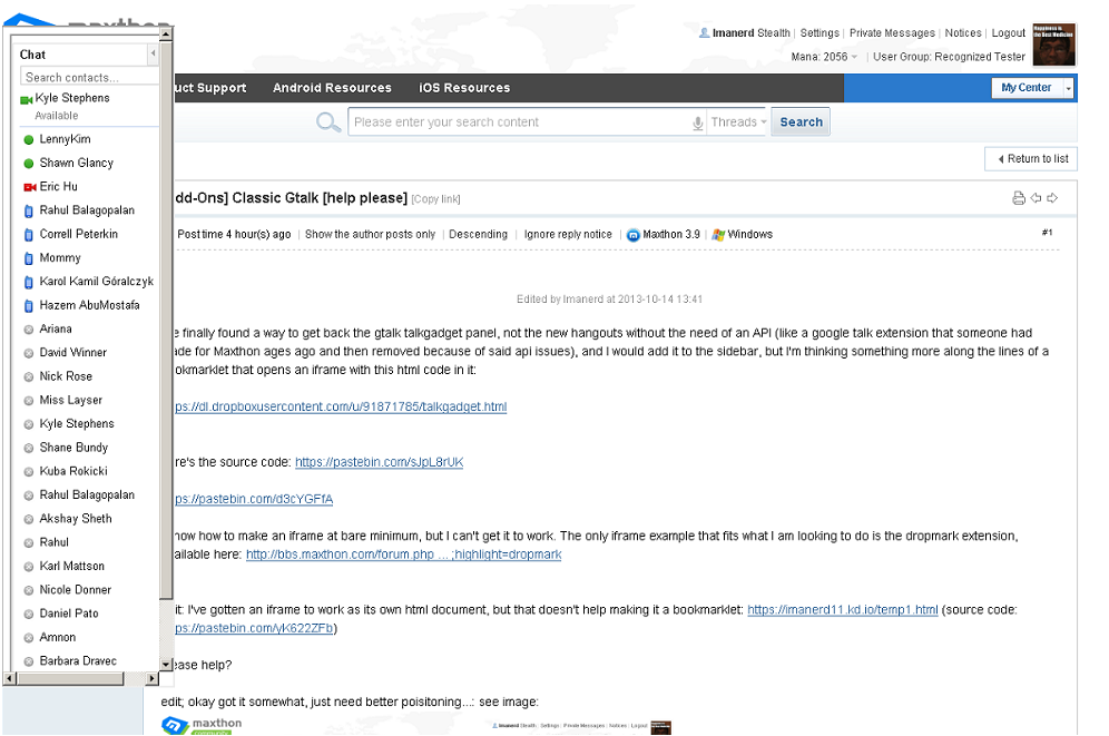

Imanerd Posted October 14, 2013 Report Share Posted October 14, 2013 edit: got it, see my 2nd post. I've finally found a way to get back the gtalk talkgadget panel, not the new hangouts without the need of an API (like a google talk extension that someone had made for Maxthon ages ago and then removed because of said api issues), and I would add it to the sidebar, but I'm thinking something more along the lines of a bookmarklet that opens an iframe with this html code in it: https://dl.dropboxusercontent.com/u/91871785/talkgadget.html here's the source code: https://pastebin.com/sJpL8rUK https://pastebin.com/d3cYGFfA I know how to make an iframe at bare minimum, but I can't get it to work. The only iframe example that fits what I am looking to do is the dropmark extension, available here: http://bbs.maxthon.com/forum.php?mod=viewthread&tid=585&highlight=dropmark edit: I've gotten an iframe to work as its own html document, but that doesn't help making it a bookmarklet: https://imanerd11.kd.io/temp1.html (source code: https://pastebin.com/yK622ZFb) please help? edit; okay got it somewhat, just need better poisitoning...: see image: 4210 here's the code:javascript:var%20ifra=document.createElement('iframe');ifra.src="https://imanerd11.kd.io/temp1.html";ifra.setAttribute("width","194");ifra.setAttribute("height","750");ifra.setAttribute("left","0");ifra.setAttribute("borders","no");ifra.setAttribute("scrollbars","no");ifra.setAttribute("top","0");void(document.body.appendChild(ifra)); Link to comment Share on other sites More sharing options...
Imanerd Posted October 14, 2013 Author Report Share Posted October 14, 2013 edit: darn, it won't work as an addon. but, YAY got the bookmarklet:javascript:var%20ifra=document.createElement('iframe');ifra.src="https://imanerd11.kd.io/temp1.html";ifra.setAttribute("width","194");ifra.setAttribute('style', 'position: fixed; top: 25px; left: 0px;');ifra.setAttribute("height","750");ifra.setAttribute("borders","no");ifra.setAttribute("scrollbars","no");void(document.body.appendChild(ifra));4214 Link to comment Share on other sites More sharing options...
Positronis Posted October 15, 2013 Report Share Posted October 15, 2013 Imanerd replied at 2013-10-14 20:50 edit: darn, it won't work as an addon. but, YAY got the bookmarklet: Hi, here is your addon. I changed this 2 attributes ifra.setAttribute('style', 'position: fixed; top: 15px; left: 0px;'); ifra.setAttribute("height", "570"); your original was: ifra.setAttribute('style', 'position: fixed; top: 25px; left: 0px;'); ifra.setAttribute("height", "750"); I set "entryPoints": , you can delete sidebar. Toolbar is compatible only for MX3Classic Gtalk.mxaddon Link to comment Share on other sites More sharing options...
