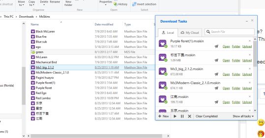

joemax Posted August 25, 2013 Report Share Posted August 25, 2013 Add a switching capability? That's been possible since the skin selector was introduced to M4. Here are some of the skins I've made or d/led since skins became available for M4, more uploaded to my Maxthon cloud. All thats needed to switch skins from the local file is one simple click. I suppose the devs could make it easier but not by much save adding a skin button like it was in M3. So despite what some people here in the forum would have you believe, it is rather easy. 3530 Link to comment Share on other sites More sharing options...
Tony Posted August 25, 2013 Report Share Posted August 25, 2013 thats not what he meant - the discussion whilst not obvious is about switching 'full' skins which now seem more possible than before - what you are changing is not a full skin but a background and a few othe changes Tony - Vivaldi 4 on Windows 10 64Bit Link to comment Share on other sites More sharing options...
