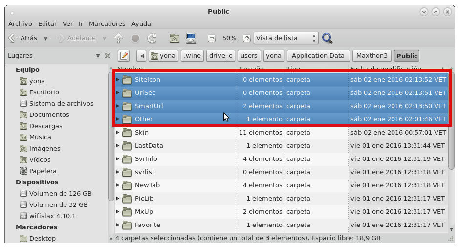

yona-tyt Posted January 2, 2016 Author Report Share Posted January 2, 2016 Just delete these directories, you need not delete "Maxthon 3" completely. Tip Give Link to comment Share on other sites More sharing options...

yona-tyt Posted January 15, 2016 Author Report Share Posted January 15, 2016 Definitely this file (SiteIcon.dat) is causing the problem. SiteIcon.dat Tip Give Link to comment Share on other sites More sharing options...
