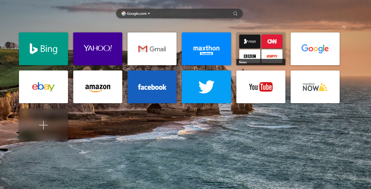

callisto96 Posted April 20 Author Report Posted April 20 another issue arose after the downgrading (now at 7.2.2.4000) my original start page with all the tiles was deleted and reverted to the default one, tried to restore the "Shortcuts" file but it didn't help, tried to re-customizing it but it revert back to the original default so I am unable to customize it anymore I am talking about the page in the image attached any advice ? Quote
BugSir009 Posted April 21 Report Posted April 21 21 hours ago, callisto96 said: another issue arose after the downgrading (now at 7.2.2.4000) my original start page with all the tiles was deleted and reverted to the default one, tried to restore the "Shortcuts" file but it didn't help, tried to re-customizing it but it revert back to the original default so I am unable to customize it anymore I am talking about the page in the image attached any advice ? Hi callisto96, do you initially have a backup of user data? If yes, you should be restoring from the local folder 'QuickAccess' and not shortcuts. Quote
callisto96 Posted April 21 Author Report Posted April 21 it didn't help as well, see the video that demonstrates the issue by the way, I had this issue before where my custom links deleted and I restored the "shortcuts" file and it resolved the issue, in this case nor the "shortcuts" or "quickaccess" helped, and as can be seen on the video even if I try to re-edit the home page with the custom shortcuts manually it still don't save the changes. please advise on how to proceed Video_2025-04-21_082928.mp4 Quote
callisto96 Posted April 24 Author Report Posted April 24 any idea on how to resolve this issue ? I hope the video was clear Quote
