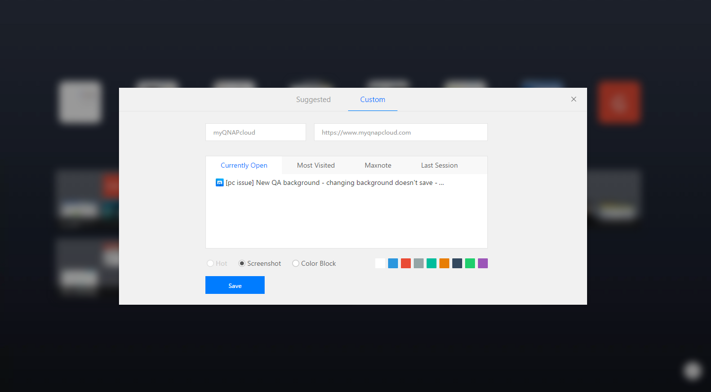

other problem with QA - latest version.
QA dont show me some pictures.
neither "hot" nor "screenshot" picture are shown. sometimes when i click "edit" maxthon dont open properties from link and goes back to QA.

22 hours ago, BugSir006 said:
Hi all, for who has the issue of background cannot be saved,
Please check that if you have ticked both of this two options? If yes, untick the upper one and try again.
Update:
this issue has been fixed today, and even if you clear other website-related data, your background for QA won't change.
Share this post
Link to post
Share on other sites
Are they neither shown nor clickable? Or, just not shown but can click?

Quote
not shown but i can click.
Quote
BTW, are you using a night mode script?
no.
adding new link works - but only "old" links from previous versions dont show - but not all.
edit: only links with "hot" icons dont work.
when i change to "screenshot" icon will be changed - but i can not change back to "hot" icon because greyed out.
That may be related to that we changed the hot icon repository, so some have changed, and some deleted.

Quote
And where is the problem to add custom icons instead "hot" icons?

please, please, please, please,
add custom icons/pictures for links in QA.
at moment QA makes no sense with "screenshot" or "color block" and grayed out "hot" settings.
1st row: 3 different links starting with same letter.
Share this post
Link to post
That will be in our future development plan.
Currently, you can use screenshot rather than color blocks to solve it. Or you can move them downwards so when mouse hovering over it, the title will show to help you differentiate.
