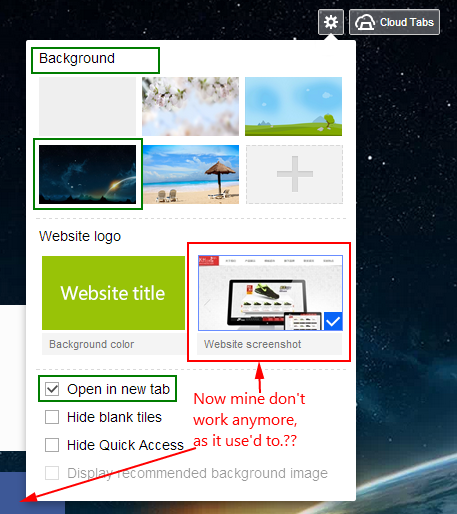

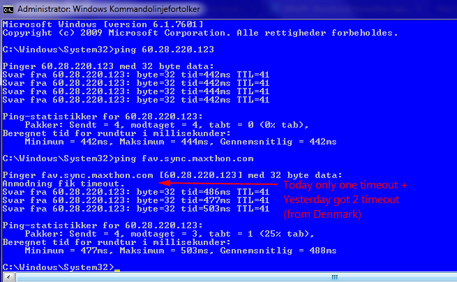

~Ohke Posted May 30, 2015 Report Share Posted May 30, 2015 I tried yesterday to Ping also, and had 2 timeout on top (50% lost), for Ping to the IP number. Today it looks like this. Strange it's fluctuate this much.?? <~ I use the free program DNS Benchmark, to find the Top best DNS for my placement on the net, got the 6 fastest DNS servers in TCP IPv4 now. So no it's not your AV that blocks. Have you any Ad block or ABP on.?? (Try turn them of) You can test it with Firewall and AV turned of, for a short moment and see if it works then (= Fav. Sync). Turn OF all the other Sync, so only Fav. is set to Sync, try Sync from here ~> about:favorites from the 3 vertical dots. And for the Quick Access it's this place you set it... How to make them work you also can see here. (^^,) <~ Those in Green works to, but Website Screenshot only works with an extra / in the url link, just like this http:///www.google.com But when your on http://fav.maxthon.com/api/fav/manager# and it says Fav. Recovered, then we maybe have to have a Mod to look at it, they can see more than me and you. EDIT 1: Hey 7twenty... You are super fast every time, i try to answer. (^^,) Ohh.. you answer here and on the other tread. EDIT 2: My Fav. Recovery works to, but it only shows up after Browser restart as it's supposed to. So it must be your browser Sync some how, because you are Login in every places, Yes.?? Hope thou, that it soon will work for you... Best Regards Ohke Remember PC's are stupid, they only do what you type and tell them, but sometime they don't... (^^,) Hardware: Everything that you can kick to.Software: The things you only can cuss over. Link to comment Share on other sites More sharing options...

Eblek Posted June 8, 2015 Author Report Share Posted June 8, 2015 Ah thank you for all attention I tried yesterday to Ping also, and had 2 timeout on top (50% lost), for Ping to the IP number. Today it looks like this. Strange it's fluctuate this much.?? PING Fav. Sync Mx.png <~ I use the free program DNS Benchmark, to find the Top best DNS for my placement on the net, got the 6 fastest DNS servers in TCP IPv4 now. So no it's not your AV that blocks. Have you any Ad block or ABP on.?? (Try turn them of) You can test it with Firewall and AV turned of, for a short moment and see if it works then (= Fav. Sync). Turn OF all the other Sync, so only Fav. is set to Sync, try Sync from here ~> about:favorites from the 3 vertical dots. The answer i think is here. Its couse from DNS. I dunno how but all my bookmarks is back !!! I was change My internet provider last week and change DNS with the new one. And now Maxthon can easly Sync all my data. And yess Maxthon its cool!! Link to comment Share on other sites More sharing options...
