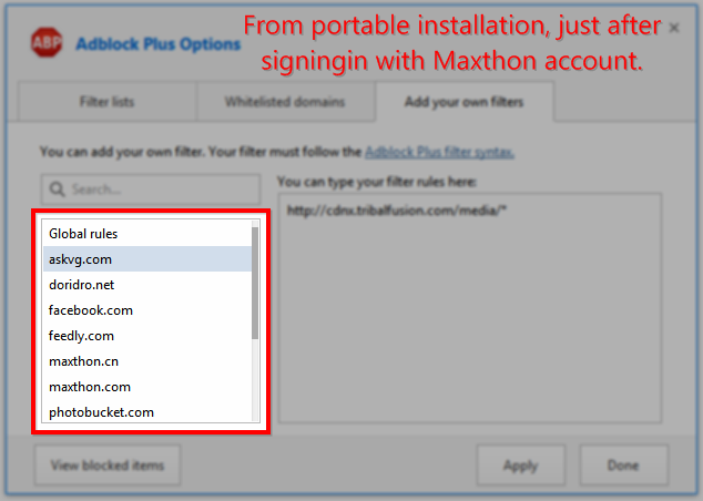

Mushaf Posted May 1, 2015 Author Report Share Posted May 1, 2015 Yes, I recently had a fresh install of v4.4.5.1000. I had synced data from a previous version. The custom filters came from that version. I did try forced-syncing after deleting all custom filters but that didn't help. I tested this with a portable installation of the same version. You can see the results below - So there's no way to clear and reset sync data on the server side like Chrome sync? By the way, in ABP, neither whitelisted domains nor custom filter subscription (like EasyPrivacy) are synced. They should be. Tip Give Link to comment Share on other sites More sharing options...

Mushaf Posted May 1, 2015 Author Report Share Posted May 1, 2015 Let's say, I have two fresh installation of Maxthon on my laptop (L) and desktop (D) and there's data from previous Maxthon version in the cloud (C.) I sign in to L, data gets updated from C, I delete custom filters and sync, custom filters don't come back to L anymore and they're supposed to be deleted from C as well after the sync. Now I sign in to D, data gets updated from C, all previously deleted custom filters get back in D now, I have to delete them again. It appears that, sync after the deletion of custom filters don't affect the cloud data. So every time I'll sign in to a fresh installation I'll have to remove the custom filters manually which shouldn't be the case. That's why I'm looking for a way to reset sync data in the cloud. Tip Give Link to comment Share on other sites More sharing options...

Mushaf Posted May 1, 2015 Author Report Share Posted May 1, 2015 Another workaround is to use a portable version of old version with Adhunter, under your passport account delete all rules and manual sync. After, test with a fresh portable of Adblock version. The workaround seems to have worked. Thanks, Oliver. Tip Give Link to comment Share on other sites More sharing options...
