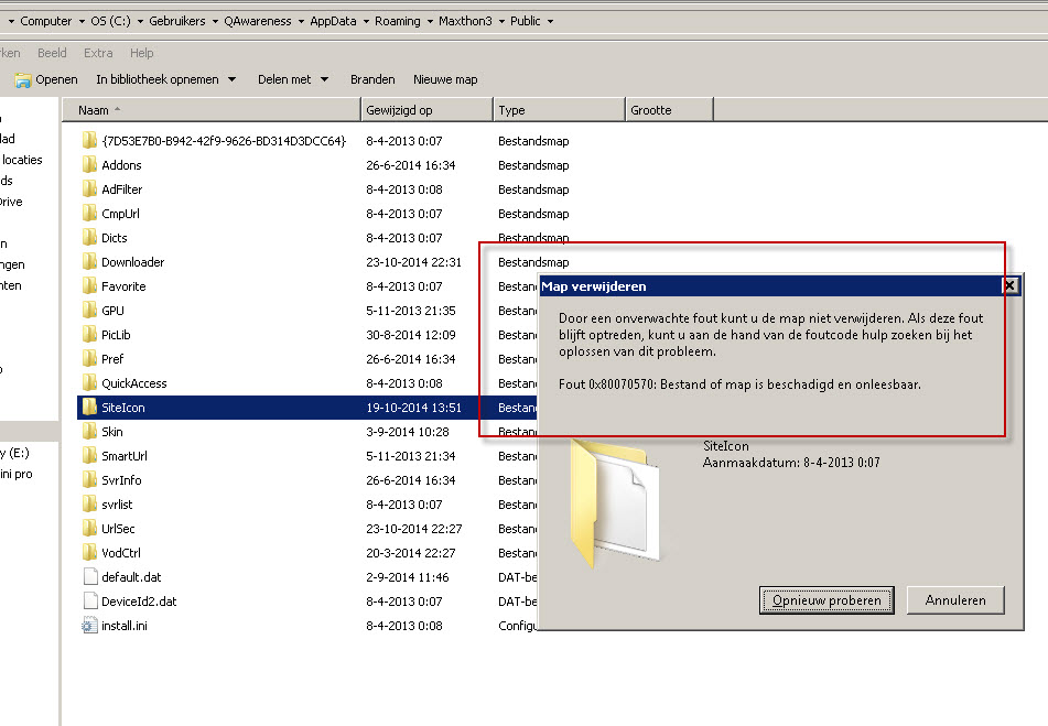

17236441 Posted October 23, 2014 Author Report Share Posted October 23, 2014 BugSir007 replied at 2014-10-22 19:10 Hello there, Welcome to the forum and thank you for your interest in Maxthon. It seems that you site ... Hi Thx. it s a bit queer, I dont see any SiteIcon folder at all in the first place. (see image) in fact there s nothing for me to delete:@ I thought I will delete the whole public folder in that case, but hereafter Maxthon would not start.( I have in the mean time put the Public folder back on line) and no , none of the sites require a pwd. they are just normal sites like BBC, CNN. some news channels etc. do you suggest that I reinstall maxthon ? Tip Give Link to comment Share on other sites More sharing options...
7twenty Posted October 23, 2014 Report Share Posted October 23, 2014 17236441 replied at 2014-10-23 18:16 Hi Thx. it s a bit queer, I dont see any SiteIcon folder at all in the first place. (see image) The path to your public folder doesn't look right? It should be in the system appdata folder: C:\Users\\AppData\Roaming\Maxthon3\Public or the userdata folder in the Maxthon folder if you're using the portable version: C:\Maxthon\UserData\Public Tip Give Link to comment Share on other sites More sharing options...
17236441 Posted October 23, 2014 Author Report Share Posted October 23, 2014 7twenty replied at 2014-10-23 02:59 The path to your public folder doesn't look right? It should be in the system appdata folder: ok Thx. so I finally reached there and on the delete action , It wont delete the folder or its content and I get the following:(see image, ...in english its the default windows pop-up saying, retry or cancel) basically its telling me : theres an address fault at 0x800.. : the folder is damaged and not readable I have closed maxthon and tried to delete the folder...nope it keeps giving me this error & wont let me delete the folder so finally we have pinned it down and there is something wrong as I can not delete this folder or its content ...is it file corruption ?? Tip Give Link to comment Share on other sites More sharing options...
BugSir007 Posted October 24, 2014 Report Share Posted October 24, 2014 17236441 replied at 2014-10-23 12:37 ok Thx. so I finally reached there and on the delete action , It wont delete the folder or its co ... Please close your browser first and try again. Tip Give Link to comment Share on other sites More sharing options...
7twenty Posted October 24, 2014 Report Share Posted October 24, 2014 Firstly, you shouldn't be deleting anything of a program when it's running - even though it should warn you if it's in use. Secondly, it seems you have found the problem. Reboot your system (if you haven't already since posting) and see if Windows asks for a disk check to be performed. If it doesn't then open an explorer window, right-click on the drive that Maxthon is installed on > Properties > Tools > Error Checking - press the check button. Windows should hopefully find and fix any disk issues causing the problem. You should then be able to delete the file. Tip Give Link to comment Share on other sites More sharing options...
17236441 Posted October 24, 2014 Author Report Share Posted October 24, 2014 will do the above when back at home today(just for the records here: i also did try to delete the folder while Maxthon was closed(no joy) & I am not on a portable version). but I know we are getting there eventually :lol Thanks for all the help here folks ! and I will report back.:loveliness: Tip Give Link to comment Share on other sites More sharing options...
17236441 Posted October 25, 2014 Author Report Share Posted October 25, 2014 it worked like a charm ! for the records: rebooted-->pc suggested a disc control to be executed-->done--->go to :C:\Users\\AppData\Roaming\Maxthon3\Public --->deleted the siteicon folder-->started Maxthon--->went through each 'blank' site --->all icons were now picked up Issue closed Thanks to all ! Tip Give Link to comment Share on other sites More sharing options...
