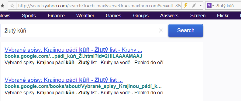

BugSir007 Posted July 17, 2014 Report Share Posted July 17, 2014 Hi djanosik, Welcome to the forum. Really sorry for the inconvenience. I used your text as a search term and my search engine (yahoo) searched for the correct term. What search engine are you suing please? Any screenshot to have a look? Looking forward to hearing from you. Thanks for your support! 9148 Link to comment Share on other sites More sharing options...
